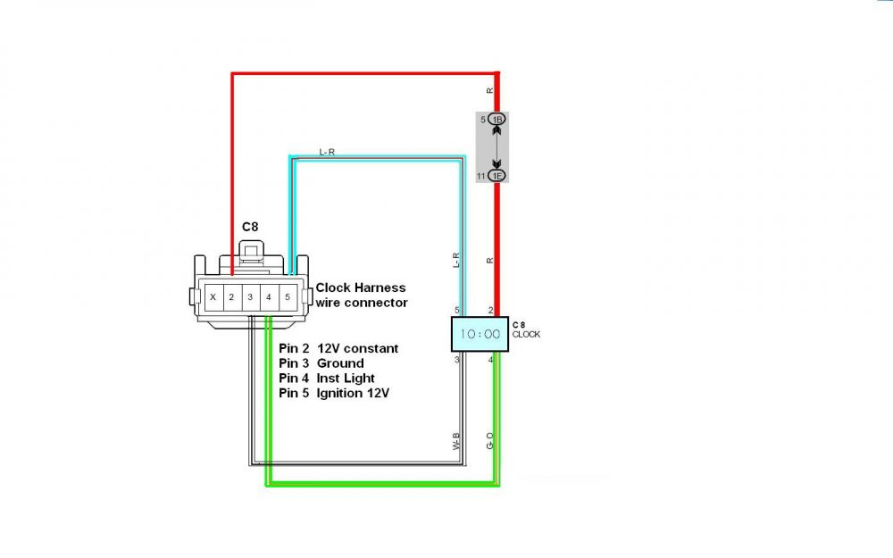

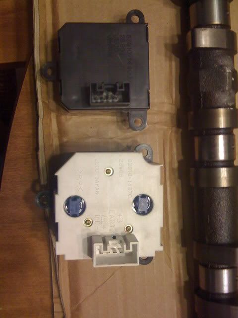

    You´ve got the wrong plug?
    Left ist pre-, right ist facelift-clock
    Here you can see the 4 pins ( or in the download link before on page 93 )

    Wd
    Here you can see 6 Pins :)
    Ahh. My fault. Even didn´t know, there where the clock with and without the temperature option. :D The 4pin clock is without the temperature-

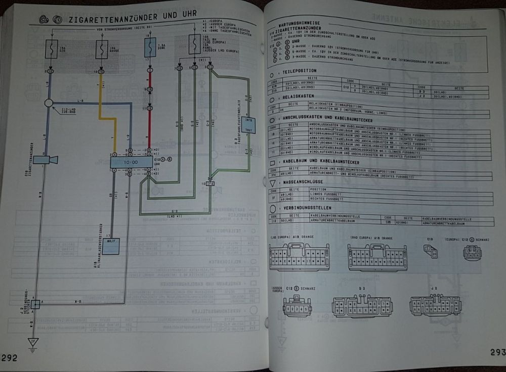

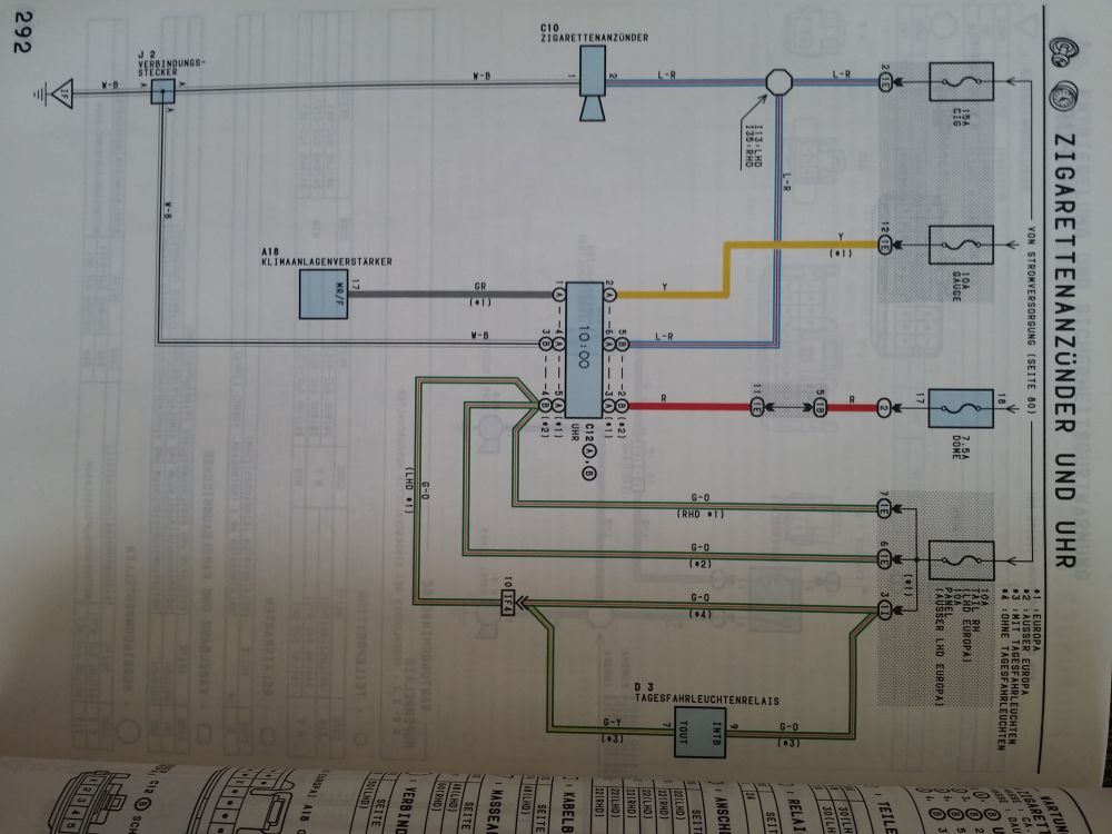

    I have the eu spec wiring book @home. If i find it, i will take a look an copy you a photo
    Wd
    Great news!!
    Great news!!

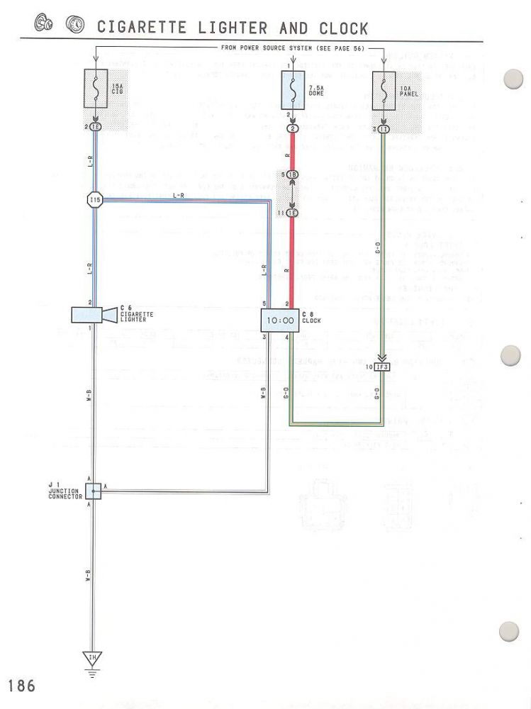

    Found it
    Found it
